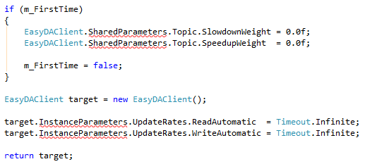

The code you sent me does not work when using my EasyOPC version 5.22:
even after adding references to all non-UA OPCLabs.EasyXXX dll.
On the website I see that the latest versions of QuickOPC target Studio 2012 and Framework 4.5.
For reasons beyond my control, I have to stick to Studio 2010 and Framework 4.0.
So, I will make the jump to subscription today.
Met vriendelijke groeten, Kind regards,
J.

21 Feb 2014 10:30 - 21 Feb 2014 10:30 #1732 by support
Hi J.
There can be multiple reasons to this, but this one is quite likely:
When you call Read, QuickOPC sets up an OPC subscription internally anyway. This is in attempt to have the values “ready” for you next time, without having to go the OPC server. QuickOPC observes the pattern of Reads, and from time to time, it adjusts the update rate of the OPC subscription. This is done by removing the items from one OPC group and adding them to a different group, which may be time consuming and be the reason of the occasional longer processing times. Writes would be affected indirectly – because (unless you specifically specify differently), only one “channel” is used to communicate with the OPC server, so while the items are being moved, other operations have to wait as well.
Other comments:
- If you commonly get 100% CPU, then you already have a problem, and that one should be solved first.
- You should really use subscriptions for this. Coding-wise, it is NOT much more complicated. It will be better in performance, and it should behave better, not worse, in high-CPU load situations. And the above described mechanism won’t apply.
If you decide to do stay with repeated Reads: We do not provide a straightforward way to disable the auto-subscription and rate-adjusting mechanism described above. But you can try to set the parameters as below – the first two are static properties and should be set just once, at the beginning of the program; the other two are instance properties and should be set on each instance of EasyDAClient (if you have more than one):
EasyDAClient.SharedParameters.Topic.SlowdownWeight = 0.0f; EasyDAClient.SharedParameters.Topic.SpeedupWeight = 0.0f; var target = new EasyDAClient(); target.InstanceParameters.UpdateRates.ReadAutomatic = Timeout.Infinite; target.InstanceParameters.UpdateRates.WriteAutomatic = Timeout.Infinite;
When doing it like this, it may very well happen that you Read times will be quite stable, but at the same time, they will be slower than what you observe now – because they will become a “true” OPC reads.
