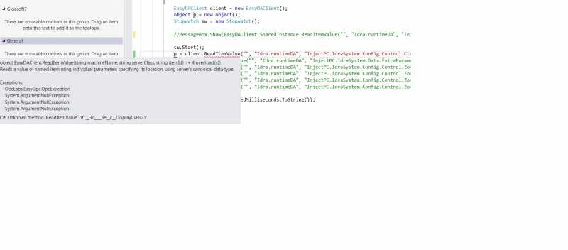

10 Dec 2013 07:33 #1599 by support
Replied by support on topic Array reading error (VT_R4)
is this error just in the "help" window of Visual Studio (i.e. just a documentation/help issue), or does cause more serious consequences as well?
This looks like some kind of version mismatch. Have you been using other build of Version 5.23 before, or an earlier version (e.g. number 5.22, or less?)
Can you please check your Global Assembly Cache, to see if multiple versions of the same assembly aren't present? (and if so, delete the incorrect ones; or delete them all, and reinstall the product).
Also, please check you solution/project directory (and, in general, the whole computer..._ - if there are copies of the (old) assemblies, clean them all, and rebuild.
I hope this helps.
07 Dec 2013 22:36 - 08 Dec 2013 17:33 #1597 by Gardoni
Replied by Gardoni on topic Array reading error (VT_R4)
After your modification (v5.23) I can read properly VT_R4 arrays from Iconics-generated OPC server. Just one more "strange" issue. After installing v5.23 I have both in VS2010 and VS2012 the attached error (see picture). Even if I have this error, I can compile, I can execute, I can debug and I can read the OPC array, but Visual Studio always have this error (Unknown method ' 'ReadItemValue of '__3c___3e_c_DisplayClass21' '
Please give me your opinion. If you need I can post the zipped VS project
Thanks, Davide
