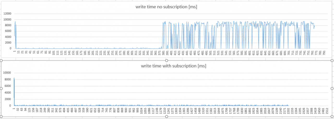

09 Apr 2018 21:34 #6223 by mpp
I plot the result of the last test in the attached chart. As you can see with the subscription the write performance are good along the whole hour of test.
Why there is such a difference with the case of no subscription?

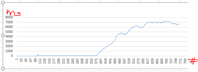

09 Apr 2018 20:22 - 09 Apr 2018 20:26 #6222 by mpp
From the first test with no subscriptions I see that after ~30 minutes the performance of the write function gets really bad.
You can see it on the plot in the attached png. (ms in y axis, number of try in x axis) in the first 30 minutes the write takes some milliseconds, then the time increases up to 7-8 seconds
