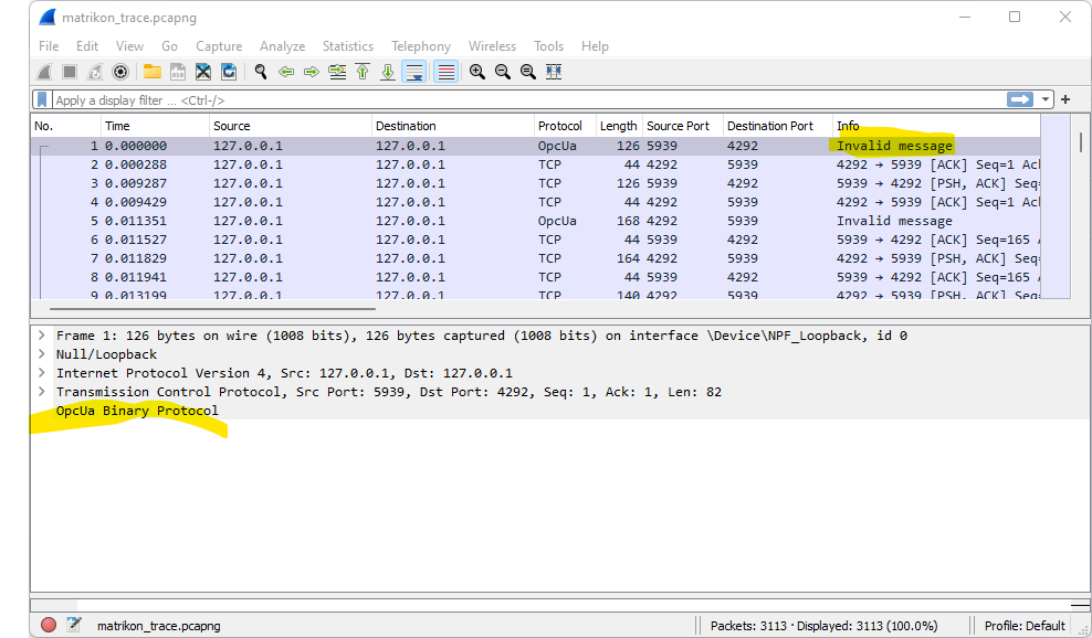

15 Sep 2023 13:34 #12150 by support
Yes, but in this case you have captured something else, not the OPC UA communication between the OPC client and the server. In your capture, all sources and destinations are 127.0.0.1.

15 Sep 2023 09:37 #12144 by support
Hello.As far as I can tell, what you have captured is not the OPC UA communication. When decoded as OpcUa in Wireshark, it gives "Invalid messages" every time.You must be able to see truly decoded OpcUa messages in Wireshark yourself - do you? Otherwise it doesn't make sense to send them over.
(you need to set "Decode As" to OpcUa for affected ports or IP addresses)
Example of what I see with your captures:
Example of how it (roughly) can look like when it is correct:
